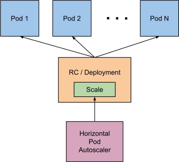

Kubernetes Automatic Scaling with the Horizontal Pod Autoscaler (HPA) Object
The Kubernetes HorizontalPodAutoscaler object updates pods, deployments and statefulsets to match demands by automatically scaling workloads. The HPA’s response to increased load is to dynamically provision additional pods. In case of a decrease in load and the number of pods is above the specified minimum, HPA instructs workloads when it is time to scale down the workload resource.
1 Jun 03 2022 07 22 01 38 AM
The Kubernetes HPA Object
Pod autoscaling is implemented as a controlled loop that is run at specified intervals. By default, Kubernetes runs this loop every fifteen seconds, however, the interval can be configured by specifying the  --horizontal-pod-autoscaler-sync-period parameter of the kube-controller-manager.
How Does HPA Work?
Cluster administrators typically deploy the HPA object either using the kubectl autoscale command with arguments or as a HorizontalPodAutoscaler object. The code shown below gives a sample declarative configuration for the HPA object:
apiVersion: autoscaling/v1kind: HorizontalPodAutoscalermetadata:  name: php-apachespec:  scaleTargetRef:    apiVersion: apps/v1    kind: Deployment    name: php-apache  minReplicas: 1  maxReplicas: 10  targetCPUUtilizationPercentage: 50
Kubernetes allows the implementation of HPA both as a controller and an API resource. The controller runs within the control plane, and periodically adjusts the scale of the target object (deployment, ReplicaSet, replica controller) to match resource metrics. On each testing instance, the controller obtains and compares resource utilization metrics against those specified in the declarative configuration file.
The HPA Algorithm
The controller uses a ratio between current and desired metric values to enable scaling. A typical calculation for desired replicas looks similar to:
desiredReplicas = ceil[currentReplicas * ( currentMetricValue / desiredMetricValue )]
This implies that if the current resource metric is 100m and the desired value is 50m, the number of replicas is calculated to be doubled (100/50=2).
