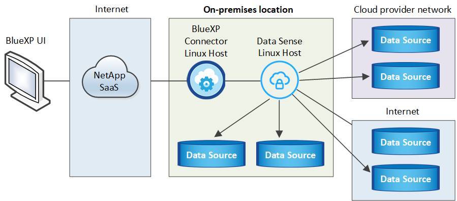

This implementation will consist of the components and connections shown below.
Data Sense on prem installment components
Data Sense on-prem installment components
Once you've familiarized yourself with the setup shown, you'll be ready to deploy the software to your on-premises Linux host, as outlined in the following steps.

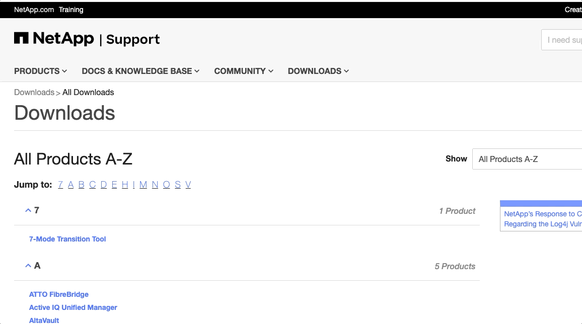

  1. Begin by downloading the installation software. Download it from the NetApp Support Site here.
    cds 3 Download Installer

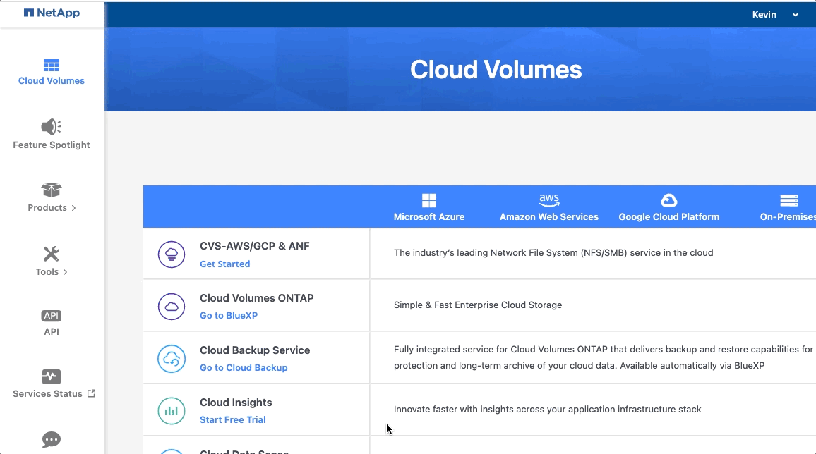

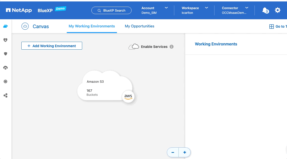

  3. Now navigate to the BlueXP home page. Click on the “Go to Console” button to open the BlueXP console, as shown below.
    cds 3 Navigate to BlueXP Console

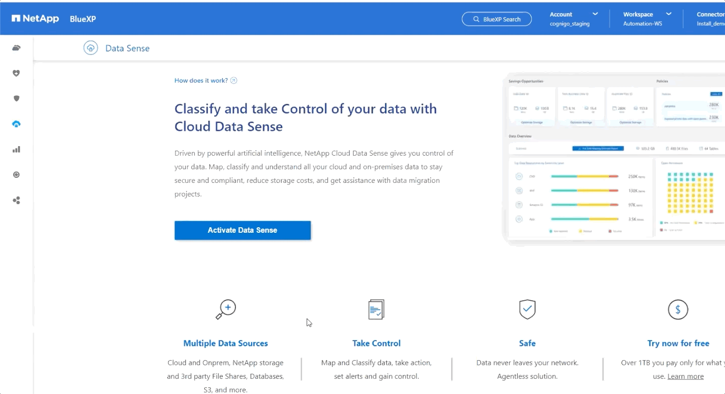

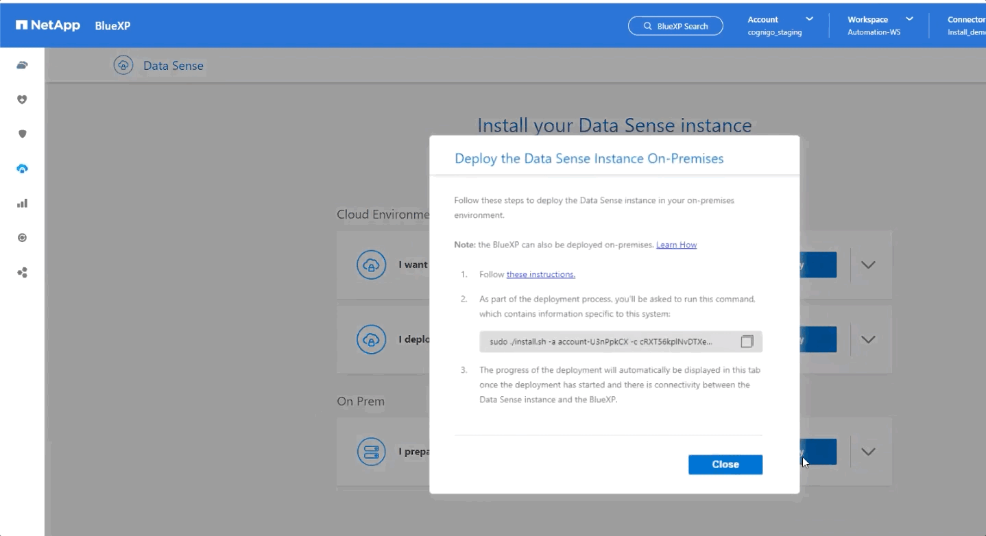

  5. On the following screen, click on the “Activate Data Sense” button. Select the “On Prem deployment.”
    cds 3 Activate Data Sense
    A dialogue box will then appear with further information about the deployment.
  6. Copy the installation command provided.
    cds 3 Copy Intstallation Command

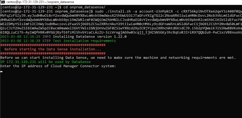

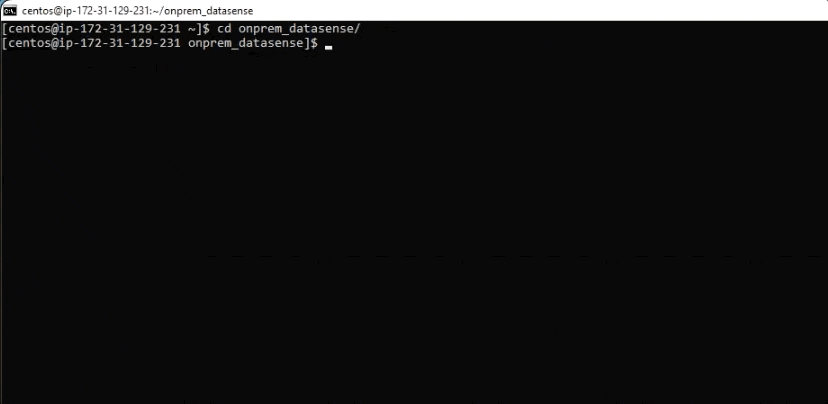

  7. Paste the installation command into the command prompt in your prepared VM.
    cds 3 Paste Installation Command
  8. Next, enter the parameters required for your installation at the following series of prompts.
    cds 3 Enter Installation Parameters
    These include the IP address of your BlueXP Connector and, where necessary, the proxy settings of your system.

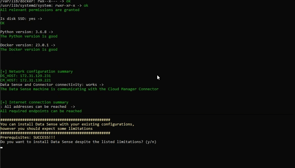

  9. The installer then performs a series of tests to check whether your configuration meets the system and network requirements for successful installation.
    Results of the test will be displayed in red, amber, or green to indicate whether a setting is unsuitable, suitable but with scan speed limitations, or good to go, respectively.
    In the example below, the user is able to install Data Sense with limitations and decides to proceed.
    cds 3 Confirm Installation

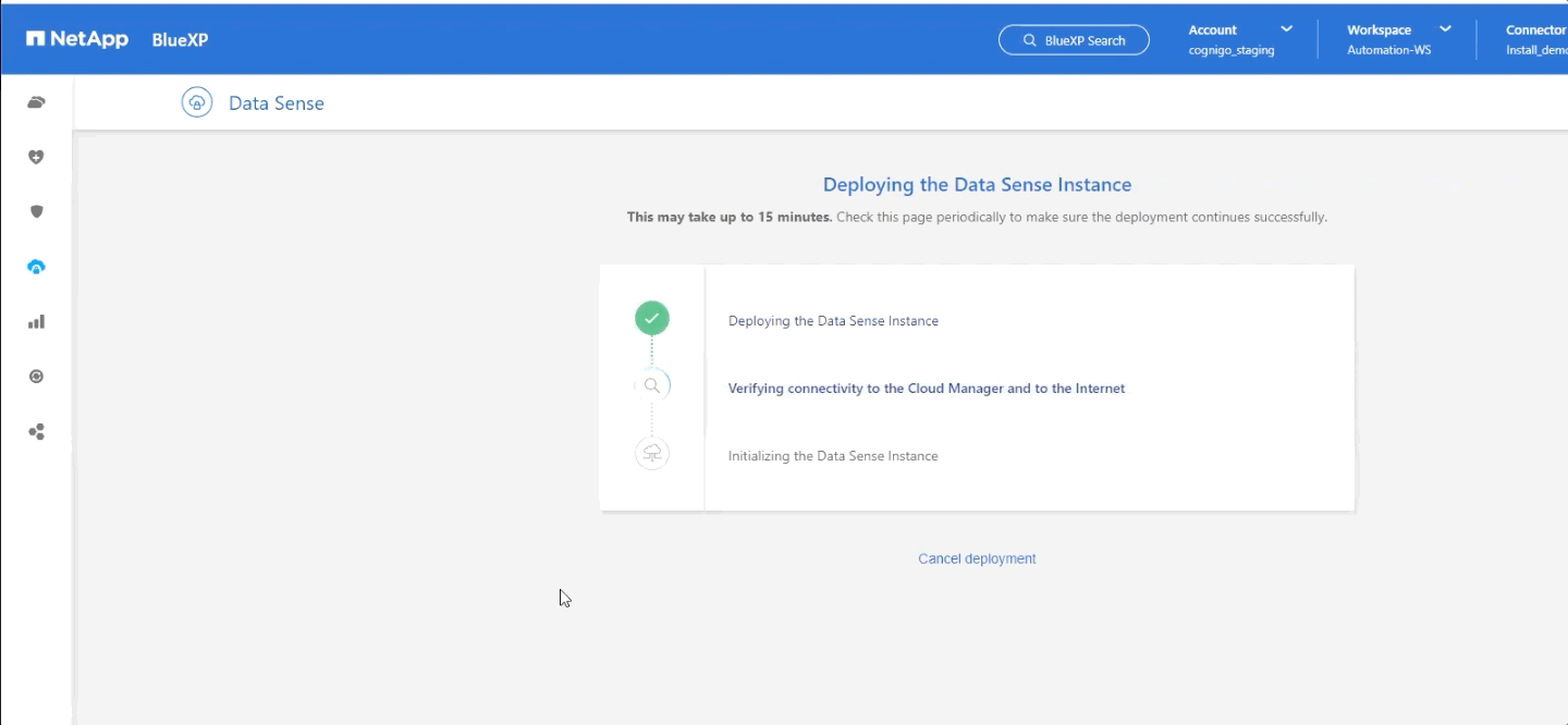

  10. The installation process then takes 10–20 minutes to complete. While you're waiting, you can go back to BlueXP to confirm the installation is in progress.
    cds 3 Check Installation Progress in BlueXP

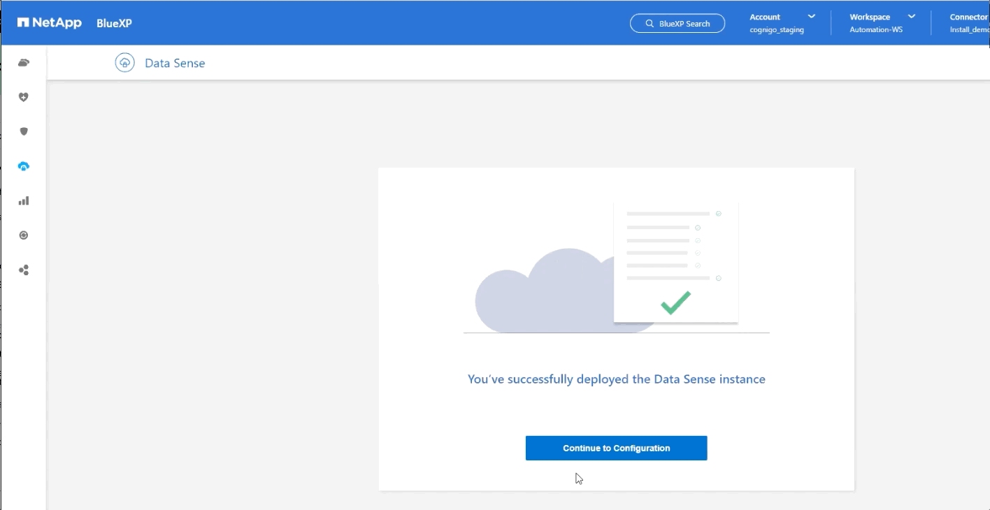

  11. Once it has finished, you can then proceed to the Configuration page in BlueXP and start adding data sources you want to scan.
    cds 3 Installation Complete
