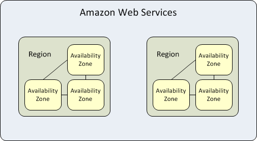

What are AWS Regions and Availability Zones?
Availability zones are highly available data centers within each AWS region. A region represents a separate geographic area. Each availability zone has independent power, cooling and networking. When an entire availability zone goes down, AWS is able to failover workloads to one of the other zones in the same region, a capability known as “Multi-AZ” redundancy.
AWS Regions
Each AWS region is isolated and operates independently from other regions but the availability zones within each region are connected via low-latency links to provide replication and fault tolerance. If you host all your data and instances in a single availability zone, which is affected by a failure, they would not be available.
The purpose of this isolation is to serve workloads with high data sovereignty and compliance requirements that do not permit user data to pass outside of a specific geographic region. These types of workloads benefit from the structure of the AWS availability zones with low-latency and complete separation from other regions.

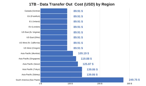

Prices of AWS service vary depending on the region based on elements like the cost of physical infrastructure and taxes. The difference between various regions can amount to hundreds of dollars, so choosing the right one is key to reducing unnecessary costs. You can use the official price calculator to see which region best suits your needs. Also check out NetApp’s AWS Calculator, which lets you calculate TCO including the cost of storage services.
Parameter #2: Cost—pick a region that offers the best price-performance ratio.
Below is a table for reference that shows the various prices for each region for a 1TB data transfer.
data transfer out cost
