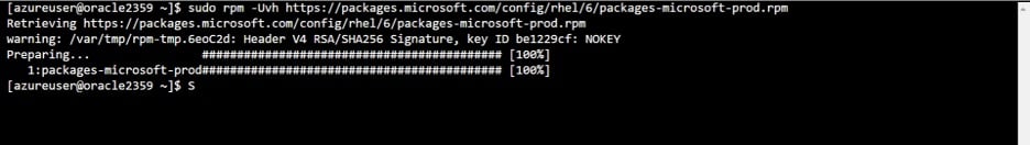

1. SSH to the Oracle VM and add the RPM repository of blobfuse specific to your OS distribution. For this demo we will be using a RHEL 6 distribution.
sudo rpm -Uvh https://packages.microsoft.com/config/rhel/6/packages-microsoft-prod.rpm

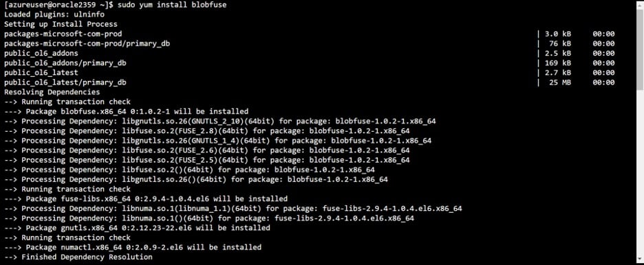

  1. Install blobfuse using the following command:
 sudo yum install blobfuse

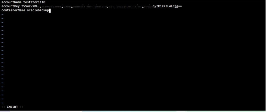

  1. Use a text editor to create the blobfuse config file
vi fuse_connection.cfg
Add the using the following content to the file.
accountName  accountKey  containerName
Replace the bracketed values with your respective storage name, access key, and the storage container to be used for the backup.
Add the contents and save the file.

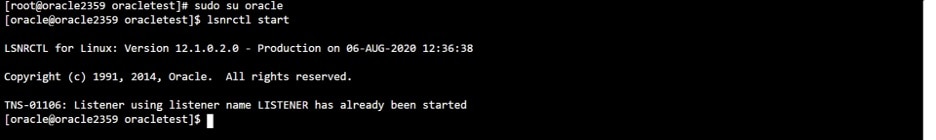

  1. Connect using the Oracle super user and check that the listener is running using the following commands:
sudo su - oracle lsnrctl start

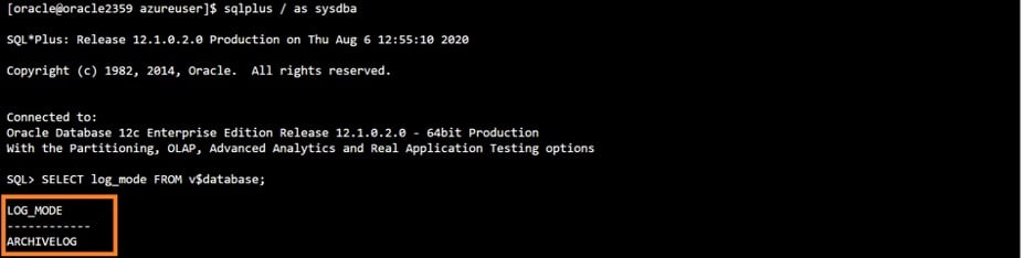

  1. Run the following commands to confirm that the database is in archive log mode:
$ sqlplus / as sysdba SQL> SELECT log_mode FROM v$database,

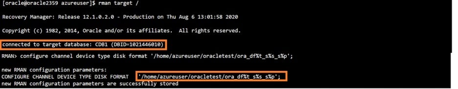

  1. Run the following Oracle RMAN commands to reconfigure the backup location and point it to the file share we created for blobfuse:
rman target / RMAN> configure channel device type disk format    '/home/azureuser/oracletest/ora_df%t_s%s_s%p',
Note: The format specifier in the command will get replaced as follows: %t is replaced by timestamp, %s with the backup set number, and %p with backup piece number. You can read more about this process here.

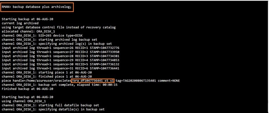

  1. Run the following command to initialize the RMAN backup:
 RMAN>backup database plus archivelog,
You can see that the backup is being stored to the folder mounted using blobfuse.

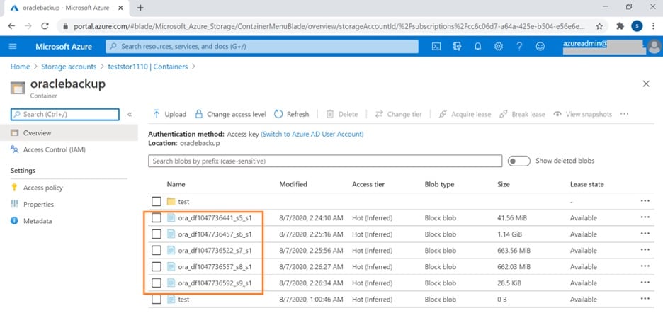

  1. Browse to the container in the storage account from the Azure portal and you can see that the backup files are present in the container:
Oracle Backup
