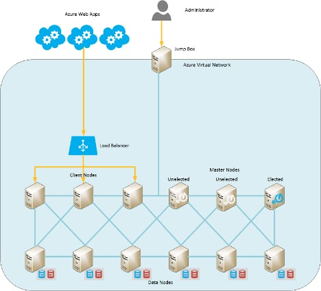

Elasticsearch on Azure: Reference Architecture
This reference architecture was provided by contributors to the Azure documentation.
Image Source: GitHub
Here is how this topology is generated automatically using an ARM template:
  • Data nodes—the template deploys three data nodes by default. These are virtual machines (VMs) that perform search, aggregate, and other data-related operations and connect to the backend load balancers.
  • Master nodes—in this topology, the dataNodesAreMasterEligible parameter is set to No, meaning that data nodes cannot be elected as master nodes. The system will deploy three dedicated master nodes—a recommended option for larger clusters.
  • Coordinating nodes—for clusters that deploy more than 100 data nodes, coordinating nodes can optionally be added to help gather incoming requests from clients, forward them to data nodes, and aggregate results.
  • Ingest and machine learning nodes—by default, all deployed nodes function as Ingest Nodes. If machine learning features are included in your Elasticsearch license, these nodes can double as Machine Learning Nodes.
  • Incremental deployment—by default, the template uses incremental deployment mode. This means that existing Elasticsearch resources in the resource group, whose settings are not modified by the template, will stay the same. New resources, or those for which the template specifies different settings, will be added or modified. The Elasticsearch deployment script updates elasticsearch.yml, and if a node uses the temporary disk, updates the data directory and permissions.

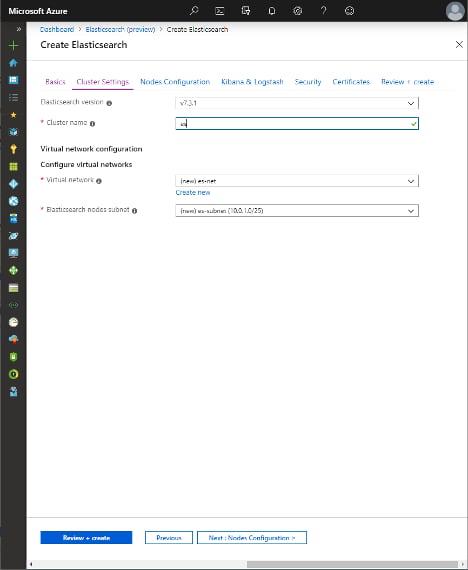

  4. Click the Cluster Settings tab, select your desired Elasticsearch version, and name the cluster.
Image Source: Elastic
5. Select whether you are deploying a new virtual network (VNet) or using an existing one. If networking resources exist in a resource group, and you want the cluster to access resources on the same network, deploy them to an existing VNet.

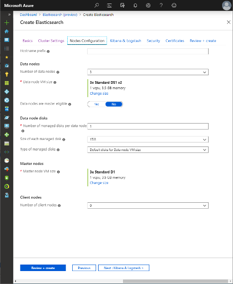

6. Click on the Nodes Configuration tab to determine the number of nodes of each type you require for the cluster. You may specify the disk size and type, as well as the number of disks for data nodes. If there are two or more disks, the system will create a RAID 0 array across them for improved performance.

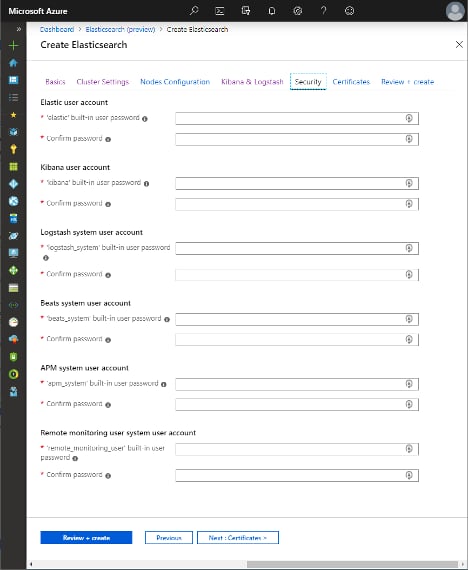

8. Define users and role configuration by clicking on the Security tab. This feature is only available during the 30-day trial period offered by the Azure Marketplace. Here you can set up six built-in user accounts, providing credentials for each:
● Elastic user account—the built-in account for the superuser
● Kibana user account—the Kibana account for connecting and communicating with Elasticsearch (from version 7.8.0 andkibana_system)
● Logstash system user account—the Logstash account for saving monitoring data in Elasticsearch
● Beats system user account—used by Beats, an open source data shipper that sends data to Logstash or Elasticsearch
● APM system user account—the application performance monitoring (APM) server’s account for saving APM data to Elasticsearch
● Remote monitoring user system user account—used by Metricbeat to collect monitoring data
