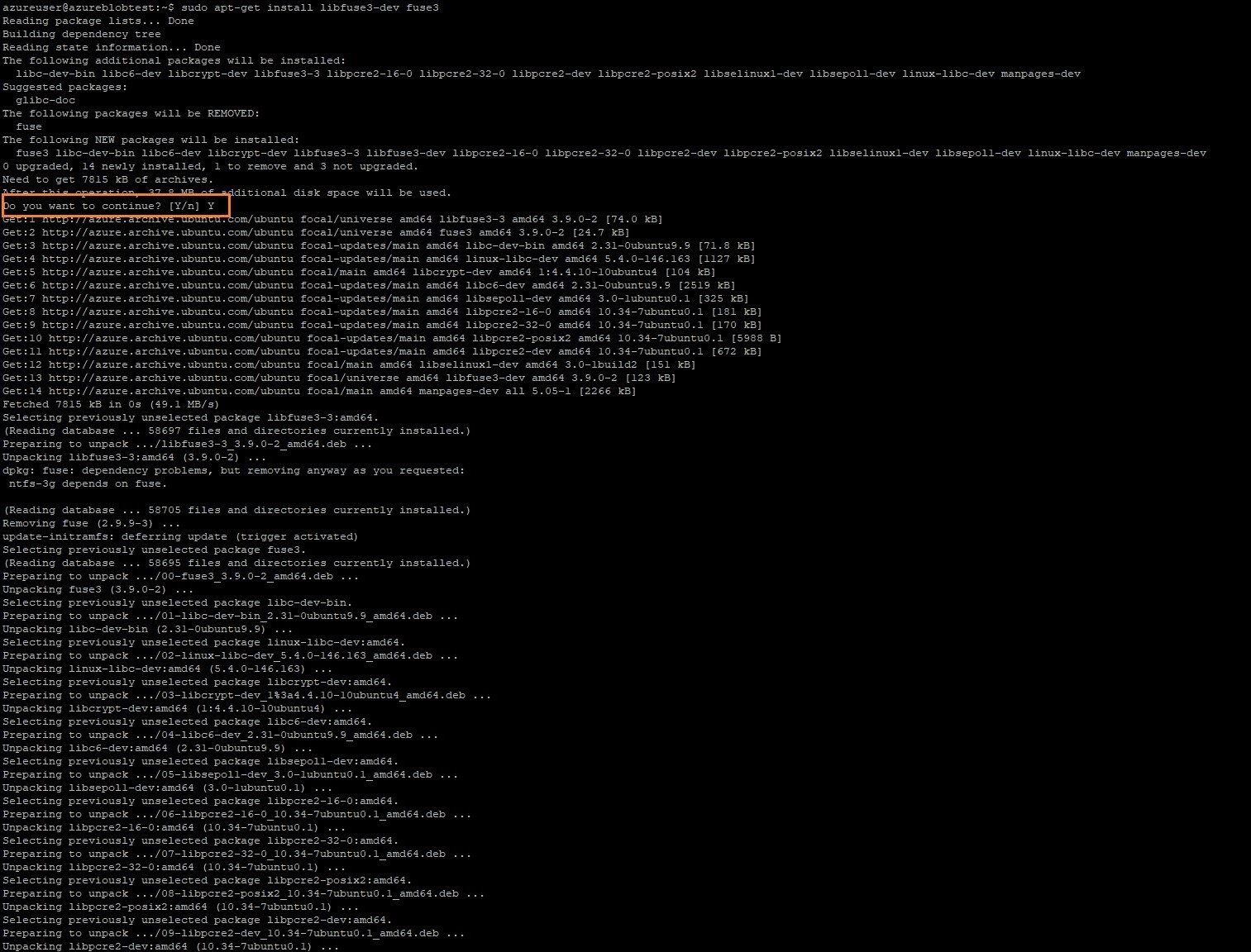

  1. Run the following commands to configure the Linux package repository for Microsoft products in the Ubuntu machine and install BlobFuse:
    wget https://packages.microsoft.com/config/ubuntu/20.04/packages-microsoft-prod.debsudo dpkg -i packages-microsoft-prod.debsudo apt-get updatesudo apt-get install libfuse3-dev fuse3
    Note: If prompted during the process to complete the installation and configuration, confirm by typing in “Y”.

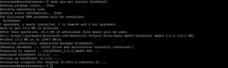

  2. Install Blobfuse by running the following command:
    sudo  apt-get install blobfuse2

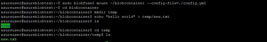

  7. Browse to the folder where the blob is mounted, i.e., ~/blobcontainer, and create a new folder and files. You can browse, access, and modify the files as you would normally do in any Linux file system:
    cd ~/blobcontainermkdir tempecho "hello world" > temp/new.txt

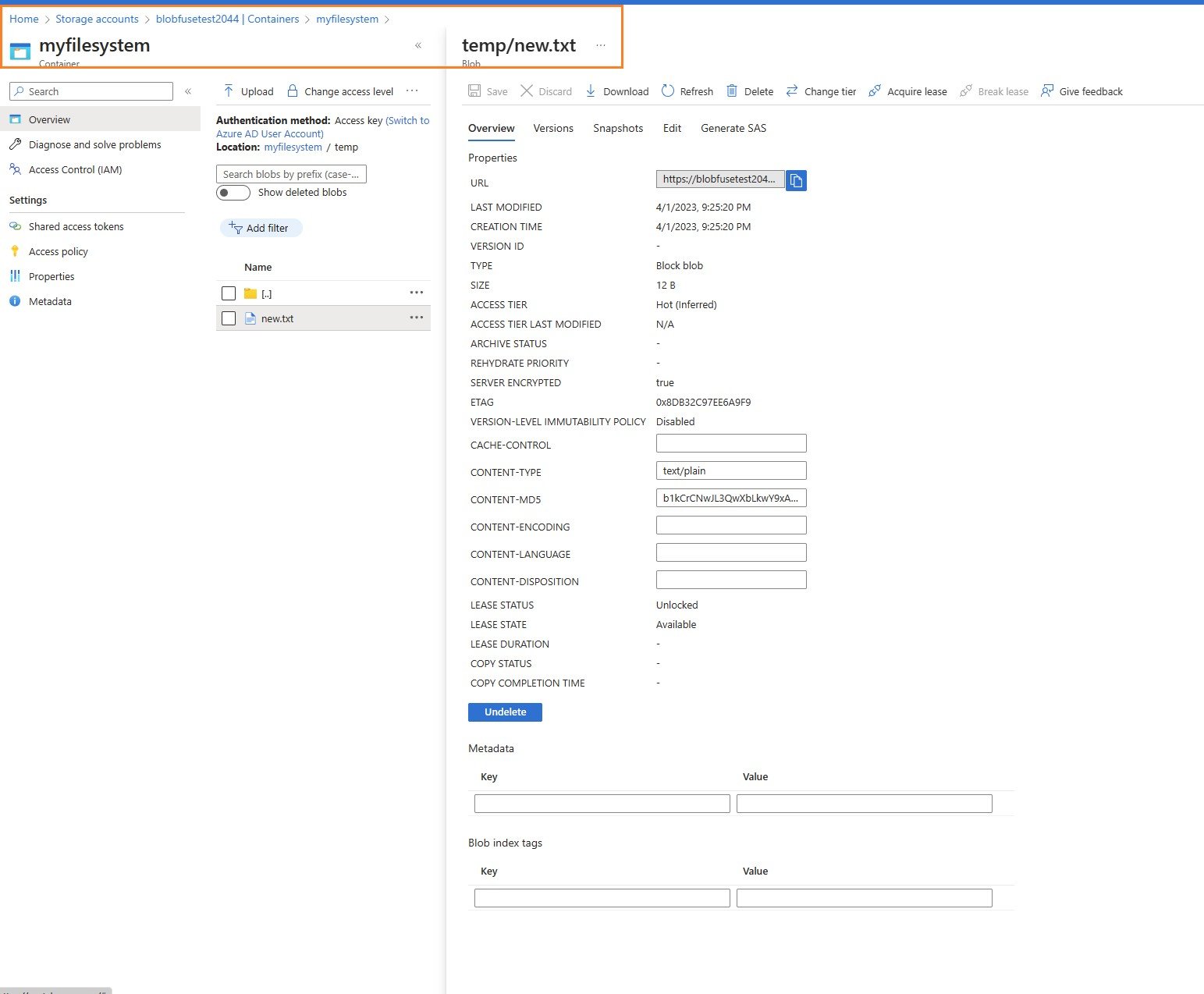

  8. To confirm that the folder and file is created in the container that was mounted in the Linux machine, go to the Azure portal and access your storage account.
